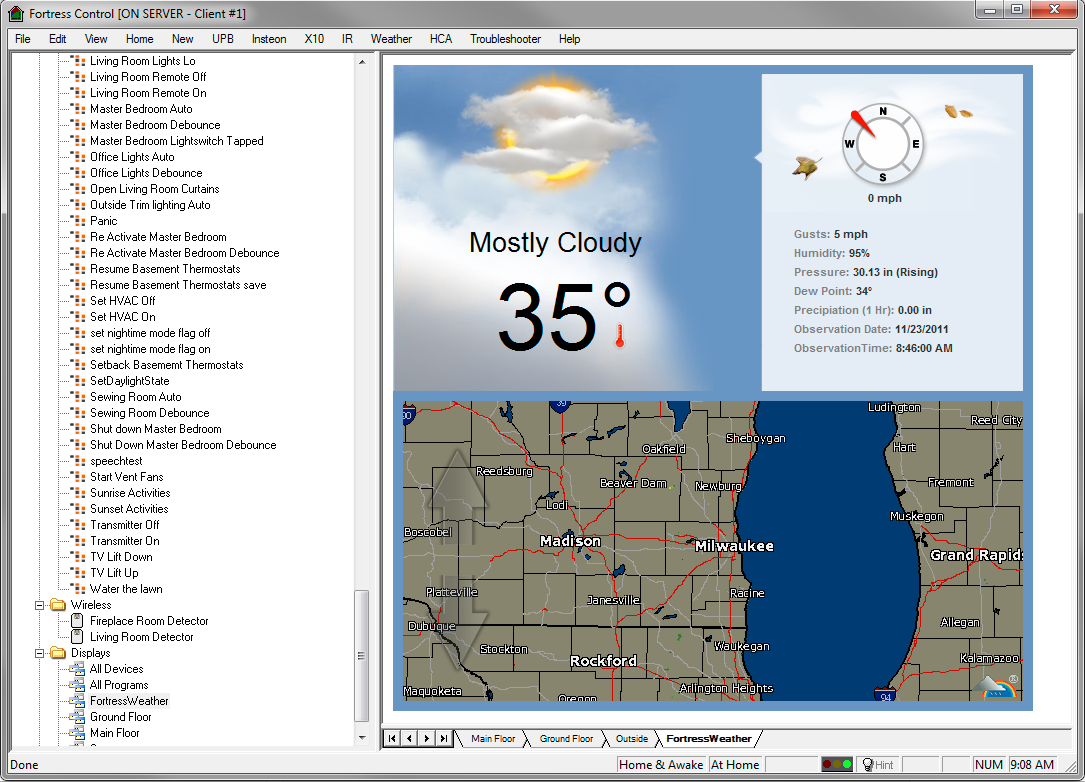

Fortress is now weather aware! I'm using data from a local weather underground station that I harvest every 15 minutes using a powershell script. I'm also obtaining cloud cover data from a local METAR station every hour. Observations are correlated then updated graphically and can be viewed by any computer running the HCA client including wall mounted displays. More interestingly, the house now has a real good idea of just what exactly is going on outside:
Posted Image
Fortress is currently tracking temp/pressure trend along with rainfall data. Rising temp trend is indicated by the red thermometer shown. I use a blue thermometer for falling temp trend. The radar map zoom can be adjusted in 60 mile increments by pressing the up or down arrows (they're transparent so you have to look closely to see them) on the left side of the map.
Additional possibilities are intriguing: I can have the house announce weather warnings such as windchill factors when we first get up in the morning. I'm also looking at additional ties to the HVAC system such as automatically placing the system into heating/cooling mode based on temp trends.
For anyone else interested in importing weather data without spending an arm and a leg on a weather station I posted a writeup on how the powershell script works along with the script itself on hcatech.com. In it I also describe how to find your nearest weather underground station. While I'm using HCA's scripting capabilities to generate server side html that is being rendered by a local webserver, the script itself will pretty much work out of the box for any automation program that can import weatherlink data. The thread is here:
www.hcatech.com/forum/showthread.php?t=396
