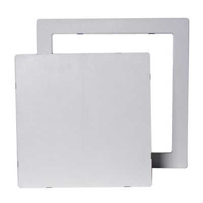

By code, the walls of the garage are supposed to have a fire rating - drywall provides this. If you penetrate it, you're supposed to maintain the fire rating. Using back boxes made of drywall will provide the continued fire rating, behind the speaker. If retrofit, it's sometimes easier to use a flexible pre-manufactured fire-rated back box. Automated Outlet sells these, made by Russound. CALL to get the best prices. Another option for retrofit in-ceiling garage speakers is to use a fire-rated speaker, with an enclosed rear (usually aluminum). Monitor Audio makes some of the cheaper ones, but you can probably find cheaper.
Similarly, you're not supposed to use low-voltage retrofit backless rings in a garage - use a high voltage fire-rated retrofit/old work box behind your LV keypads and other penetrations. Slightly more difficult to use, but similar cost.
Don't use these in a garage:
Posted Image
Use these:
Posted Image
And just a reminder not to use these plastic drywall access panels in a garage:
Posted Image
I have one in my garage ceiling, and I need to replace it. It hides a gate valve that controls an exterior spigot that is prone to freezing. I'll probably replace it with a fire-rated access panel, or I'll extend the handle through the drywall ceiling.
