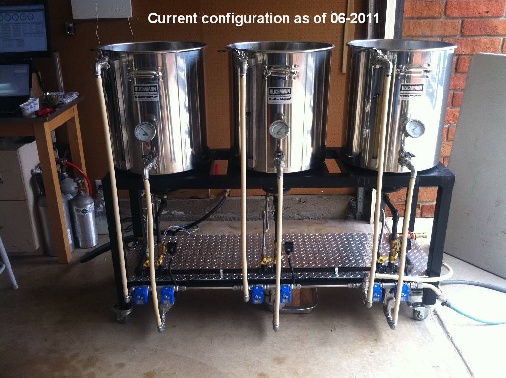

Yes, they are latching. They are SS ball valves that require power to turn the motor for either open or close. If you remove power in either position, it will stay in that position. They do make a capacitor based model that can close the valve in the event of power loss, but I've not seen those models in use.
I use 6 of them on my brew system. At the end of a brew day, I open all valves and then unplug the system so the valves stay open.

LOL. It's a home brewery... uh, I should say, automated home brewery.
In the upper left corner you can see part of the touch screen control for monitoring and controlling processes.
Yes, home automation extends into home brewing. :D
