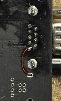

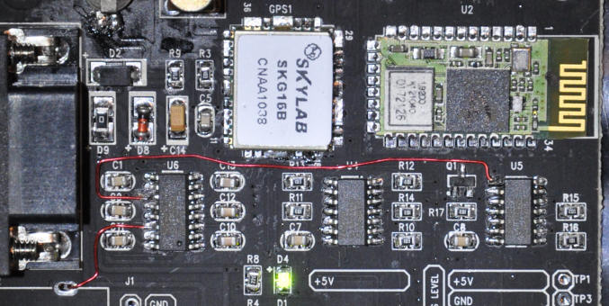

I did a modification to this board for PPS.  Easy.
Meeting the PPS over RS-232 requirement
The purpose of the patches is to provide a true RS-232 level PPS signal on pin 1 (DCD line) of the connector.  Whilst the PPS signal on test point TP9 could be used, it is at CMOS level and not RS-232 level, and may not be recognised correctly by the RS-232 receiver chip in your PC.  You can try it if you like, of course.  I have provided a Serial Port LEDs program to show the status of the RS-232 control lines.  Fortunately, there is an unused CMOS-to-RS-232 level converter gate available in U6, with its input on pin 11 and its output on pin 14.  However, as this is an inverting gate, and we want a positive going PPS signal, it should be driven with a negative going PPS signal.  That available at TP9 is positive going, however it is also used to drive the ridiculously bright blue LED through a CMOS inverter gate in U5, so by taking the output from that inverter on pin 8 of U5 we have the required negative-going PPS signal to drive U6.
The two red patch wires shown below were added by me to provide an RS-232 level, positive-going PPS output.  Note that with the Windows NTP port, the DCD line must be asserted (positive going) as provided by this patch, as that port cannot use an inverted DCD signal.

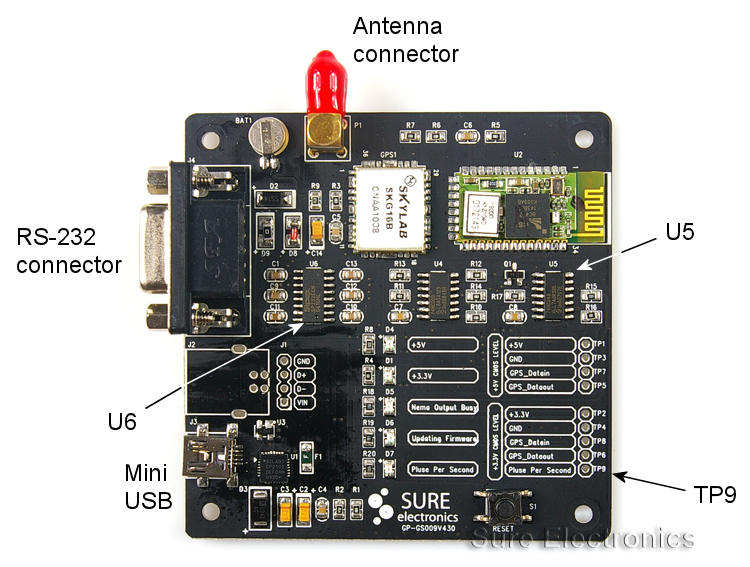

You can purchase the board at Sure Electronics for $35.00 USD here:
http://www.sureelectronics.net/goods.php?id=99
The board comes with a GPS antenna and USB cable.
The board is tacked to a 2X4 in the attic with a cat5e to RS-232 connector on it running down to the basement.
