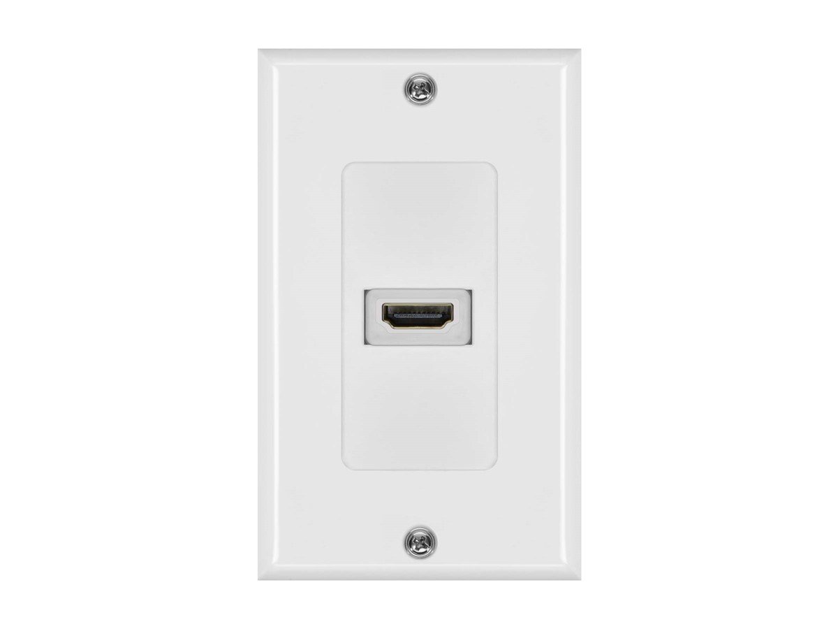

Greetings,
I like the looks and idea of the HDMI wall plates such as the ones below.  It looks clean and no open holes to the insulation sheetrock etc.  However, I am not thrilled by all the extra connections as now instead of 1 cable (TV to device) I need to have 5 (Device <=> Wall Plate <=> In Wall Cable <=> Wall Plate <=> TV).
Or do you all typically use something similar to below and just one single cable?
It's even worse than that, since every connector has a connection point between the wire and the pin in the connector.
The more connections you have in an end-to-end cable run, the more it will degrade the signal quality.  Since HDMI is digital, a given packet of data will either get their correctly or it won't.  It may work fine for a 1080p connection today, but have problems when you upgrade in the future.  The only way to be sure would be to run a qualification test on the installation once it is in place.
Since you probably won't need to plug/unplug the cables between the TV and the wall or between the wall and your other devices very often, I'd skip the wall plates.  They look nice, but the signal quality trade offs aren't worth it, in my opinion.

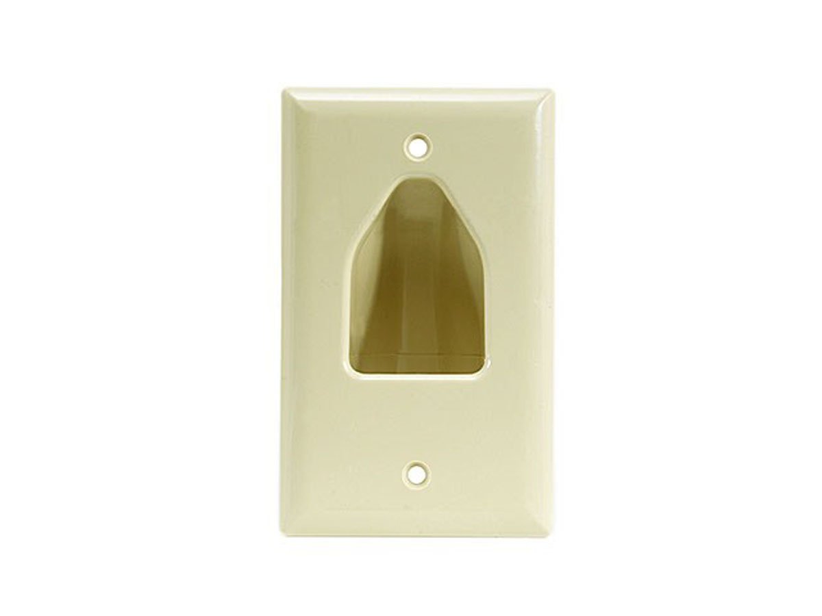

At this time, I only use the scoops. I will run more cable than I need and just let it hang there in the wall. If I need it, I'll pull it out. It keeps everything clean and accessible while giving me a direct connection.

I have a scoop in my Amazon cart at the moment. It will be hidden behind a rack.
I have some concerns about the brushed pass-throughs. Drvnbysound, do the brush fibers spring back after a year, if cables are moved? I'd definitely use them for visible locations, if they didn't get mangled.
After a year... I'm not sure honestly. My concern with the scoops is that there is nothing to restrict any air flow (HVAC loss or critters for that matter) - while the brushes aren't 100% effective at stopping either, I felt they were slightly better than an open scoop.  Additionally, the scoops provide that "cup" to the wire which begins to mold it to turn; the brushes I get don't have that and allow the wire to come out of the wall at almost any angle. When working with some of the thick HDMI cables I found this to be a pretty significant benefit.
