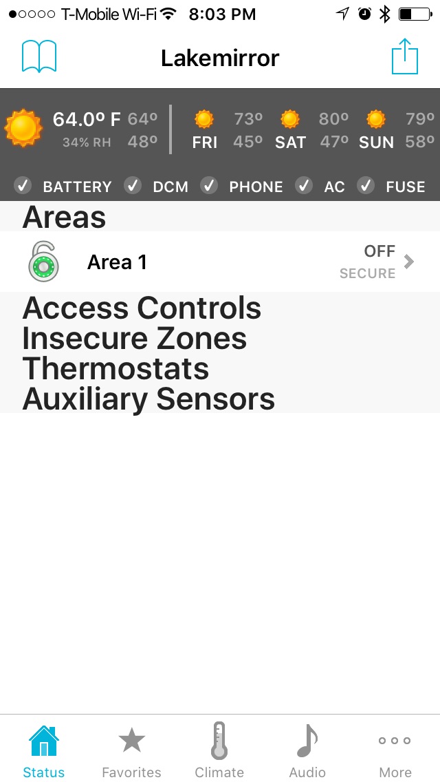

1.  Haiku main page.  The security setting is there and you can see the status panel from the OP2 (battery, DCM, etc).  The security setting (area 1) is correct and settable.  This page should also be showing the 2 doors and 1 window that I have open at the time of this screenshot as insecure zones, and it should show the 12 thermostats in the house.

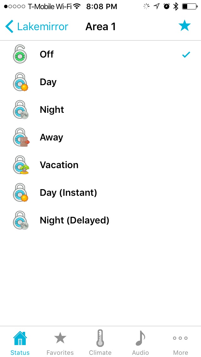

2.  Pressing area 1 allows me to see the correct current security status, and select a new one.  This works fine.

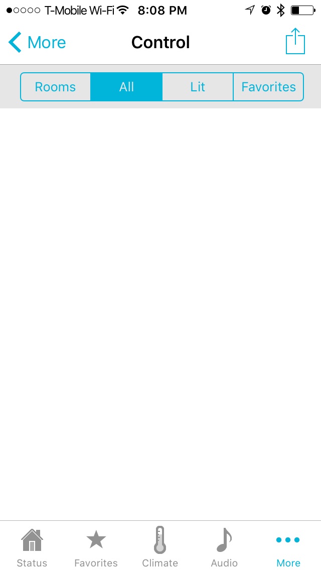

3.  Pressing the More tab at the bottom and going into the Control area shows a blank screen.  I have 72 ALC lighting controls in the house.  None show up here, under any tabs.  What does work, interestingly, is the all on and all off feature.  That's also true with the audio (all zones on or all zones off)

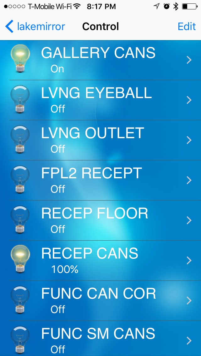

4.  Just for the heck of it, here's the Control tab on snaplink.  All ALC circuits appear and are controllable.  Snaplink also shows my buttons, thermostats, audio (hifi2), etc and allows me to control them.
