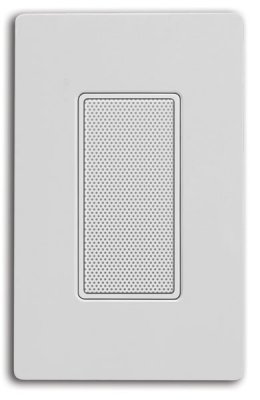

I like the look of these Decora speakers, though the Elk would be easier to use.
http://www.rdlnet.co...ct.php?page=803
8 ohm vs. 32 ohm

above is from RDL
Russound also offers one, also 8 ohm

They both look nice, but cost 5x to 10x what the Elk speaker costs.
