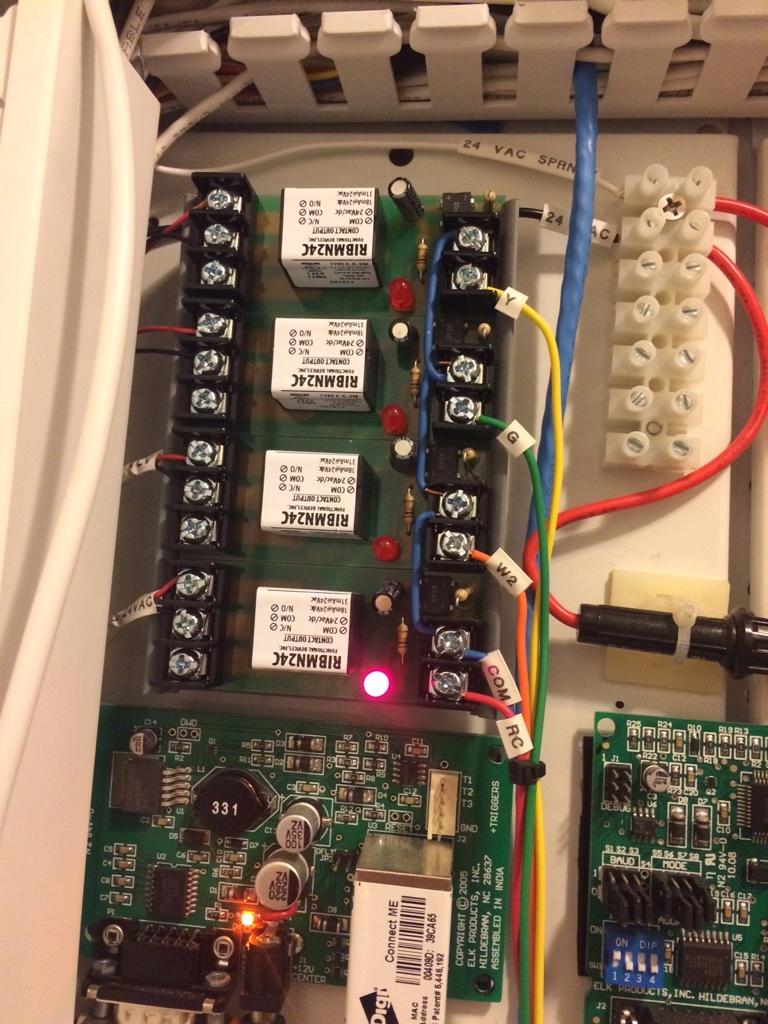

I have an Elk M1g with TR-16 thermostat. Connect with Homeseer HS4 now but same UltraM1G plugin as HS3. I added 4 24vac relays tapped into the thermostat outputs so i can monitor what it is doing and determine mode for events and other HA logic.

991dbdfd5ad467590d6bd0a4960d9f32.jpg Sent from my iPad using Tapatalk

I thought whever triggers were just what mode is selected. Not if it is in an actual running state. That why went with the relays to see when the fan or compressor or changeover valve for heat was called for and running. I have a TR-16 connected to my M1G but did not see where it would report actual running states. Did i miss something? Sent from my iPad using Tapatalk
