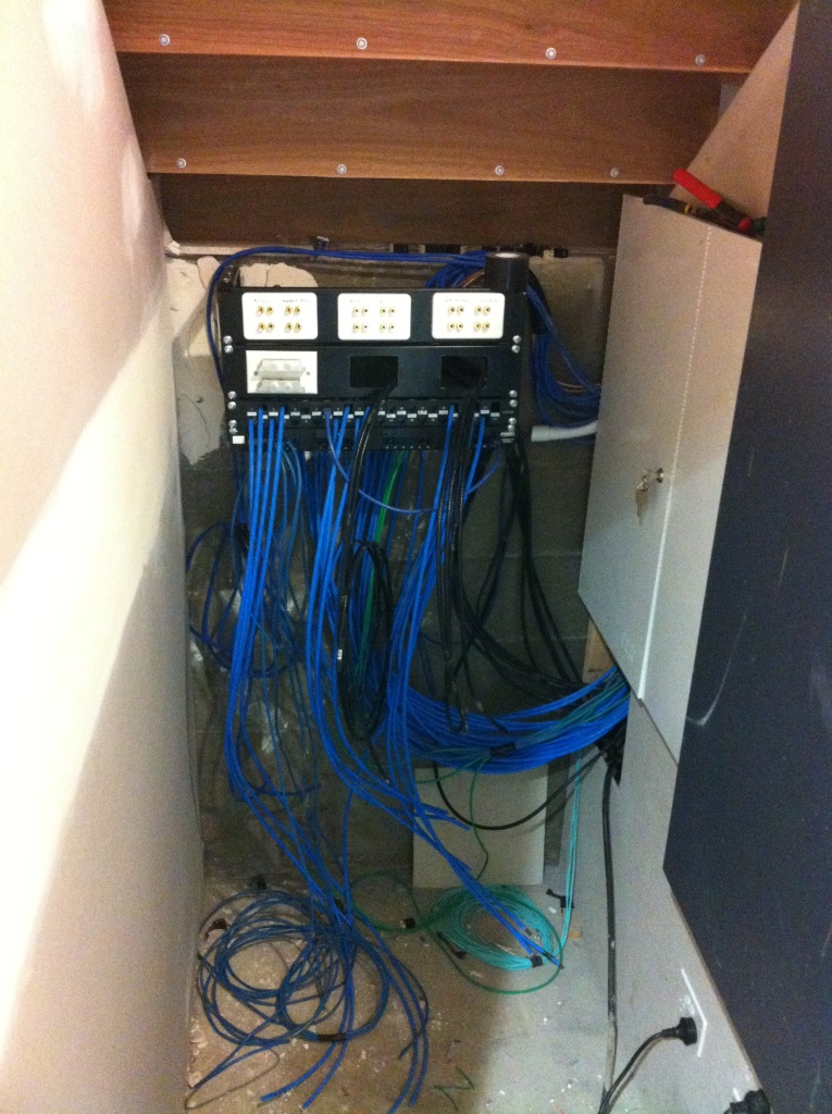

Here 6 of the 7 pairs of speakers for distributed audio around the house have been fitted off. There is one pair left for the garage, which may just be run directly into a mini amp of some kind and mounted on the wall beneath the rack. Also the RG6 coax run from the roof antenna for free to air TV is terminated on the middle left wall plate with a 4 way splitter. The roof antenna coax run and two TVs are connected on the back of the plate, with two available taps for some HDHomeRun tuners on the front. Another RG6 coax run from the roof is also terminated on the same wall plate ready for future. The two middle RG6 coax runs are also from the roof and will be terminated into 2 way splitters on wall plates in the same approach to make it easier to distribute at a later date. The last 4 RG6 coax runs which go to rooms with media on the right will be terminated for patching at a later date.
