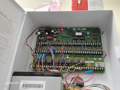

My Omni ll pro has started to turn All Lights On without human direction. Totally random times about once every day.
Any ideas as to how to stop this is much appreciated. Thanks

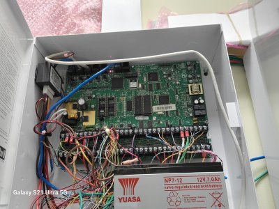

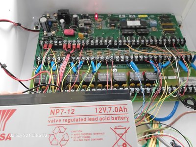

One motherboard two daughters. All light switches are HAI. Setup pics attached.

Thanks for the pictures. If the light switches are HAI you probably have a UPB lighting system. Notice the flat cable connected to serial port 3. Follow that cable and see what its plugged in to. A picture will help.
Very difficult to trace due to the placement so it will take me a while. Can I accomplish the task by removing the flat cable from serial port 3?
If that cable goes to the UPB PIM then yes. If it goes to something else then no.
The PIM will be plugged in to an outlet. There is a drawing of the PIM in the attached manual.
