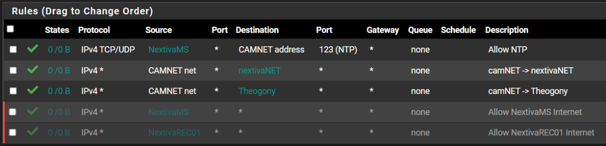

Here's my Camera Rules attached.
The top one is my NVR time sync.
Next allows my CAMNet access to an offsite recorder over a vpn.
Next allows cameras to iSCSI storage device.
That's all. Nothing else needed.
The bottom 2 are to allow the NVR and recorder access to the internet to do updates. I leave them disabled until needed.
