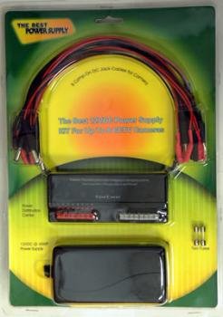

I would have to agree. That power supply would be doing well to do one camera (if that). I have a 8 port distribution block kit that runs off of a 4 amp supply that I have had pretty good luck with. It has 1 amp fuses for each camera power and 8 crimp-on CCTV power cables too. It's a nice step between the little plug shown and a full wired box. I've been selling them for $50 to installers if you need an option.

Your selling the distribution block, cables, and four amp power supply for $50? That sounds like an excellent deal. Do you have any pics of the setup?

I sell them to installers for that price (retail for $89). They don't seem like much but they work really great when you don't want to put in a full wired box. Here's what they look like packaged:
wow, that's a pretty good price then! Do you have a link to a page which shows all the specifications? Thanks!
Sorry, I don't have a link to the specs. The specs I have are pretty much listed above. What other information were you looking for?
