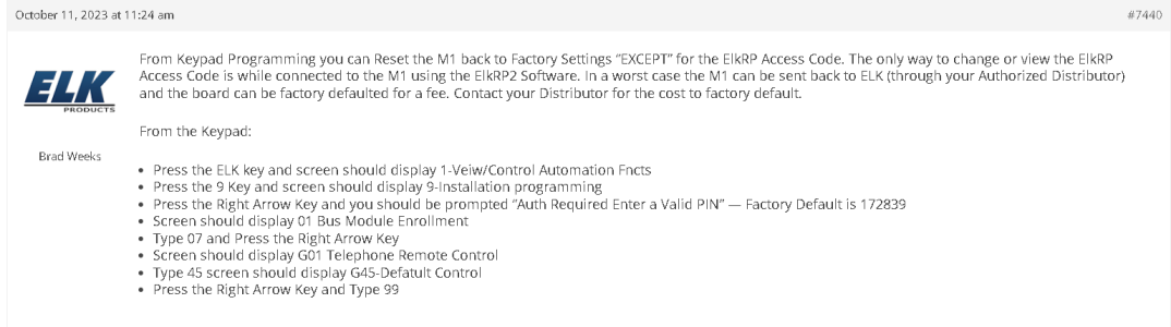

You can send the panel back to Elk to have them factory reset it. Then RP2 will work.
