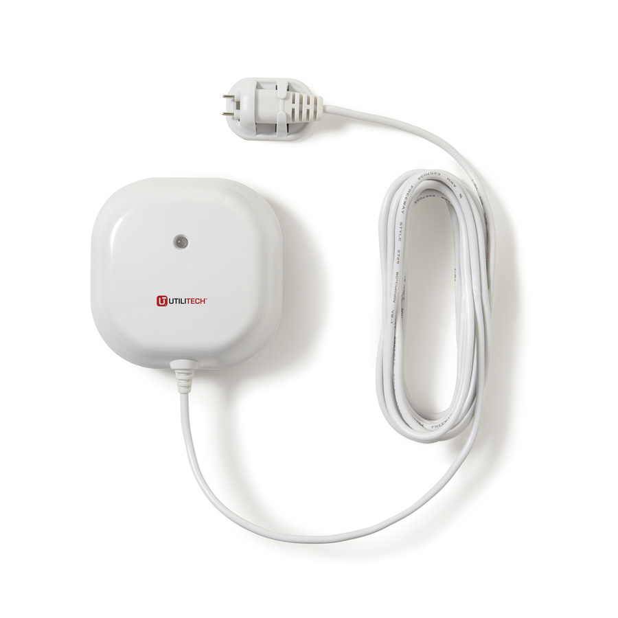

Wouldn't a simple flood sensor meet your needs?  e.g. Here's a z-wave one:
http://www.lowes.com/pd_422362-45367-TST01-1___?productId=4740940&pl=1&Ntt=flood+sensor#img
You'd just position the two metal probes at a height above your current float.  That way, if water were to bridge the gap between the two probe contacts, you'd know your sump or your float wasn't working properly.
