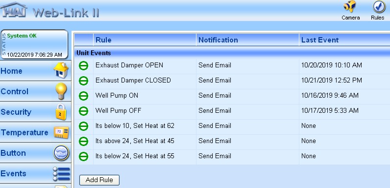

I still have Web-Link running alongside my OMNI-2e and it has been sending email alerts that I had configured many years ago. But ISP/email changes recently kill these alerts. This is a mostly-vacant second home in Northern Minnesota that requires tight management of plumbing, heating a backup power systems in -30 temperatures.

( you can still run WEB-Link in Chrome or modern versions of IE, but many features are gone, including management of RULES/email alerts)
Rules are Back
Rules are Back
