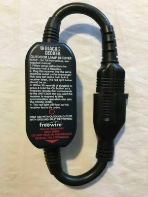

Way back here purchased a few outdoor Black and Decker Freewire X10 modules. Using these today for outdoor Christmas decorations. I am also using two Freewire modules now for two Landscaping DC transformers.
