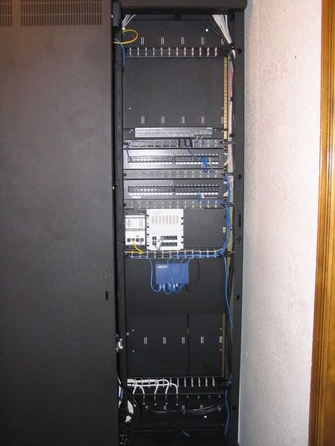

My first question concerns mounting. Here are a couple of pictures of my main rack:
This rack is in the house and I had originally hoped to leave enough room in the back of it at the top for the security stuff, but I don't really think that I did. I'm considering installing a large can in the wall to the right. The rack would have to be swung open for access. Do Y'all think that's nuts, and are there any code or UL issues with that? I do have another possible location, but it would need to be concealed some how. Maybe with a mirror.

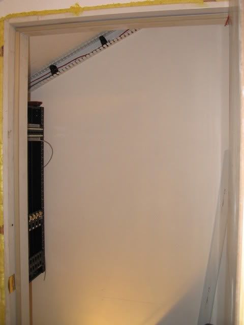

In the shop, I have a closet that is barely 24" deep. There is plywood attached to the back wall. I'm planning to install a can on that wall, but it seems to me that I've seen installations that were made directly to the backer-board. I'd be interested in an opinions on that. As long as I'm adding pictures, here's one of the closet:
There's a pathch panel on the left and the security can would mount on the back wall towards the right side. The cables would ingress from the wire mold above.
