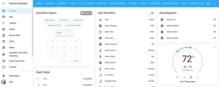

This board will work with Home Assistant / OmniLinkBridge or Homeseer Omni Plugin.

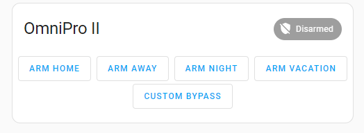

I recently switched from OpenHAB to HomeAssistant. Setup was pretty easy. You do need to also setup OmniLinkBridge as the broker for the MQTT messages between the OmniPro/Omni IIe and HomeAssistant.

Home Assistant (free) will let you manage and control and automate the Omni panel.

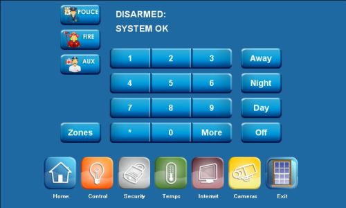

Here one screen of the Homeseer Touch interface running on a tabletop tablet.
The same touch tabletop tables run custom OmniPro Touch screens...
