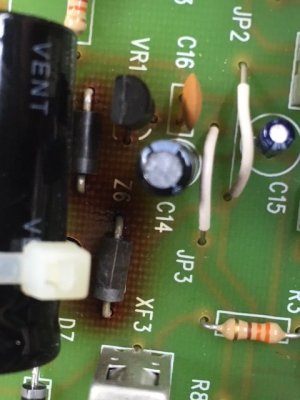

I just happened to notice mine was dead completely. There are two protection diodes and a 5V regulator that are cooked and dead shorted. I was afraid to spend the money and time replacing those parts only to find out the rest is bad because of their failure. So I bought a used one that does power up, but still won't see or repeat any signals.
