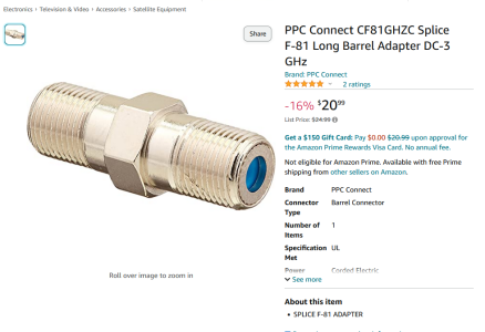

I could use a F connector straight splice that has some extra length but all I have seen are short and threaded all the way. The attenuators and ground blocks they use have a bit extra length that is smooth for the connector boot to seal on. Like the picture (Amazon). I found them but they are $20 in single qty. I can get 100 for twice that but don't need 100!
