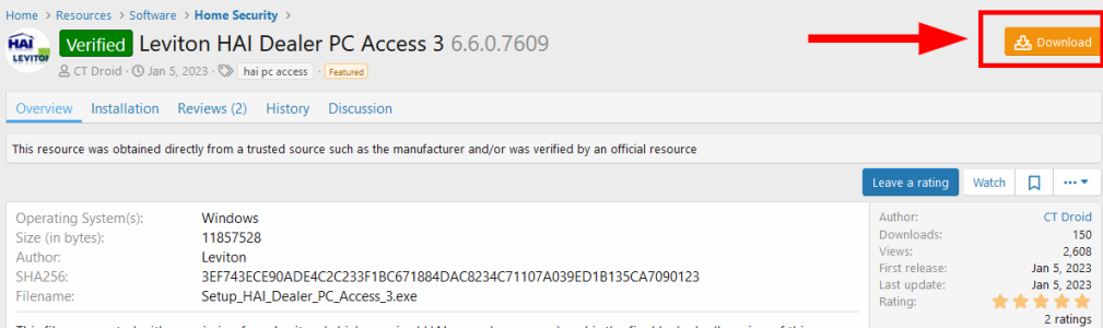

The installer is available via the orange download button on the top right once you click the link in the original post here (but you must have an account to see the download button). I agree it's not as visible as it should be (will address this after the next forum software update).
