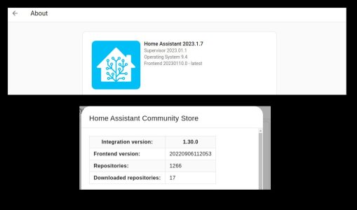

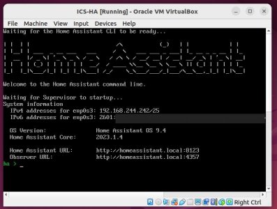

Home Assistant - did another back up of running main system. Stopped HA running on main server. Brought up VM (VB)
I procrastinated a bunch here as I preferred to run HA on native Ubuntu-Linux. Its been over 2 years now and running fine except for some errors that I kept ignoring.

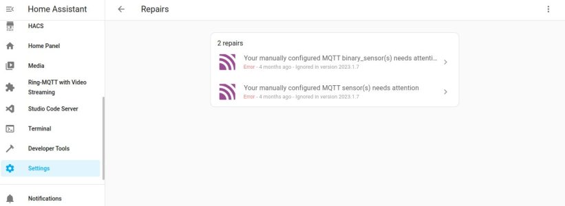

Uploaded and installed back up from running HA box. Versions now up to date with only a couple of yaml errors being ignored.
Will let this run for the next few days. Disabled HA services on main computer for time bean. All add ons are running fine. Need to change Mosquitto server to new IP...can wait on this for now.

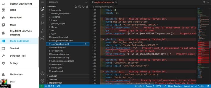

Getting used to using Studio Code server. I currently just utilize SSH, Nano and SFTP to edit Yaml files

Day 2 - shut down all HA services running in Ubuntu on box 1 and enabled auto start of HA Virtual box on box 2. Switched running main HA to new box. Working well. I have updated HS4 to current beta so copying current running version and backups from box 1 to box 2 today.
Days 3-4 - HA is running fine except if I change the HA IP to host or old HA IP. If I change the HA IP to host then that shuts down my remote desktop connection to the host machine. If I change it to the original running HA IP then HA keeps restarting. Maybe today will shut down original HA host to test. Might be something else running on PC. Geez PC was running Mosquitto Broker and I uninstalled it this morning.

Ended up changing the HA VM from a DHCP address to an unused static IP. Long term will shut down original server and IP.

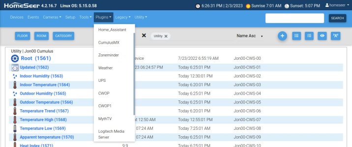

01/30/23 - HS4 running via service on new hardware. All looks well There are links in HS4 which go to HA, Zoneminder (changed to new IP), CumulusMX and Internet page for Cumulus. All is working fine. NOTE to run aspx in Linux you need go to usr/bin folder. In that folder is the file vbnc. Open vbnc in an editor and change vnbc.exe to vbc.exe. Use test.aspx to check.

02/03/2023 - changed IPs to a few devices. Created links in HS4 to:
CumulusMX, Zoneminder, Weather (Internet Weather CumuluxMX), UPS servers - 5 UPS Status, CWOP (weather), MyTV, LMS...Blue Iris,).
