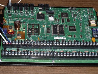

I intend to use this modem as this is a good combo provided by the internet provider, and the separate router was not helpful. I am far from snap link. Can't forward a port. How do you interpret the ping? I tried to add device with reserved ip, added the above address. Needed to add MAC address. with arp command, I received 0:7:a6:0:7c:d6 There are some numbers missing. I added '0'. Not sure it's correct. But after adding the device, it still dont show up in the list of devices to open port. I tried to create address outside of the range of the DHCP, but it doesnt let me
dwalt
The MAC address is labelled on the Omni 2e. Its on a chip just below the data port and to the right.
