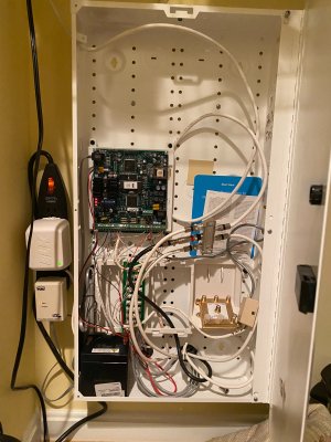

What specific device is needed to get an Omni LT online for remote access? I'm assuming this board doesn't already have this capability. Thanks!

Also, I just learned the internet router is in the same closet as the Omni, so I got that goin' for me, which is nice. And, I got a photo too.

You have a few issues to work thru.
The OmniLT does not have a network port. It only has one built in serial port which you are already using for the UPB controller.
The HAI remote access App only works with the OmniLTe or Omni2e or OmniPro II.

No, the UPB PIM is the device plugged into the outlet strip directly to the left of OmniLT. It connects the OmniLT to the HAI dimmers.
It looks like the system is still connected to the phone line. If you turn phone service back on, you can use the built-in phone interface to remotely control the system.
