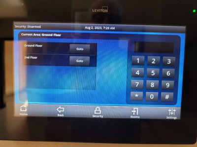

Dwalt, I am so grateful for your assistance. Here's what I see.
Looks like there isn't any "all "option.
Either disarm both areas separately or create a button to do it or add a program line to disarm both when either is disarmed.
