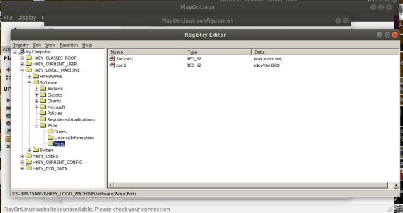

Here are the steps required to connect to a serial port in PlayonLinux running Upstart.
1 - connect your UPB PIM (serial) to serial to USB adapter * using standard UPB-Serial PIM or PCS UPB PIM and not an SA USB PIM (will not work).
2 - if it is the only USB to serial adapter on your Linux box it will show up as as /dev/ttyUSB0
3 - go to your terminal or command line prompt and type:
ln -s /dev/ttyUSB0 ~/.wine/dosdevices/com1
4 - run Upstart and connect to com1
You can also use regedit in PlayonLinux to do this:
Turned out I had forgotten to stop the Home Assistant instance and it had the com port locked. All is well.
