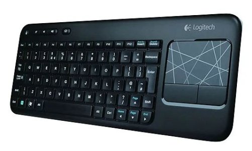

Standard (years now) wireless keyboard floater here is the Logitech K400 combo which I seldom use for the Kodi boxes. Linux is a no frills OS. Just the meat that you need to run multimedia.
FireShot Capture 056 - Logitech Wireless Touch Keyboard K400 withLogitechKeyboardCombo.jpg

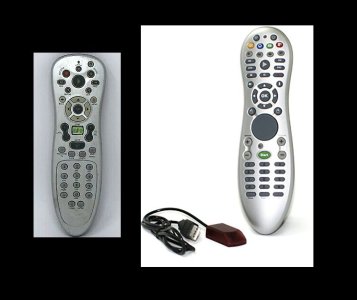

For MythTV IR connectivity purchase a Microsoft Media Center IR remote and IR receiver. The remote is large and easy to use with MythTV TV GUI. MythTV will recognize the remote automagically.
MythTV MCE Remote
MCE Remote​
  • IR transmit and receive are supported on all generations of mce transceivers, as of lirc-0.8.6.
  • Some newer devices may require post lirc-0.8.6 cvs for full functionality
  • Historically, there were separate 1st-gen and 2nd-gen drivers, lirc_mceusb and lirc_mceusb2. They were merged into a single lirc_mceusb driver as of lirc-0.8.6, which as noted above, supports transmit and receive on all devices.
