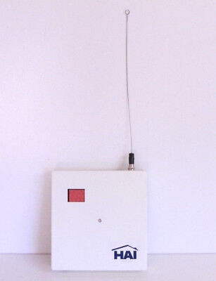

In addition to the other GE QuickBridge receiver variants out there (that do work with HAI), there is this one:
HAI 12A00 which uses Linear SX, MegaCode and Supervised S1 protocols.
Pop this url in the wayback machine to see details from 1998: http://www.homeauto.com:80/wirlrcvr.htm
This ebay seller thinks its an RF lighting control.... I doubt it.
