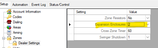

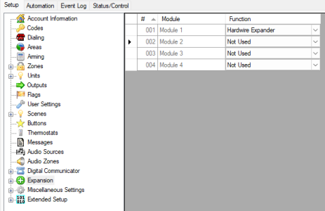

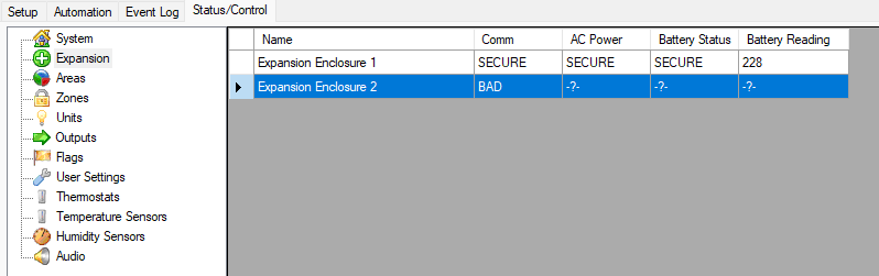

I have an HAI OmniPro II (4.0B) and PC Access shows a BAD expansion enclosure, however, I don't have a 2nd expansion enclosure. I have a primary panel in the basement, and an expansion panel upstairs.
I recently had issues with phantom beeps and ultimately completely disconnected a wireless controller - could that be the cause? If so, how do I fix it?
Thanks for confirming - I was hesitant to make the change, since I wasn't the one that set it up initially, even though I was pretty sure that it was the wireless receiver. All set now...thanks!
