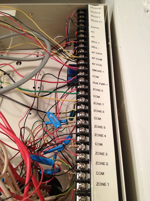

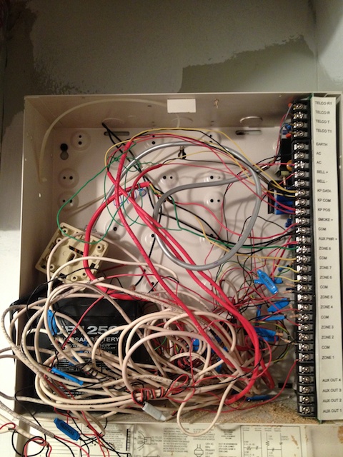

Here's the current system (and yes it looks awfully messy but for some reason it works still...)

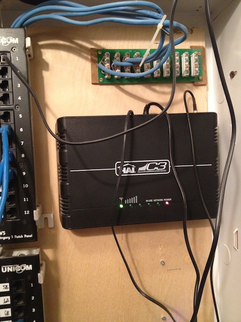

It's connected to a Hai C3 to provide cellular monitoring (via Alarm Relay). I don't have a landline in the house.

Have I missed anything? I presume it will just be a case of figuring out which wire in the existing box goes to which sensor, and re-connecting to the elk. There's some resistors in there too - I'll need to do some searching to figure out if I still need them. I see quite a lot of discussion about these.
