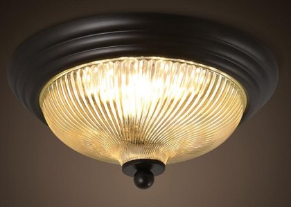

I have ceiling fixtures circa early 2000's in all of the hallways here. They look like this:
House One has 6 of these in the 2nd story and main floor hallways. House two has 5 of these ugly looking ceiling fixtures made of glass and mirrors. Will take pictures of these fixtures.

These fixtures are all glass and mirror with four candelabra LED bulbs - ugly.

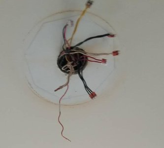

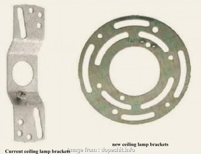

The ceiling lamps were all mounted using brackets pictured on left to use the standard 4" mounting holes in all of the fixtures. I am changing all of them to the ones pictured on the right. The electrical contractor ran many wires through all of the ceiling boxes here such that I am pulling all of the wires out and redoing them replacing the old style wire nuts with Wago wire clamps to use less space up. Here is an example of one box which personally is a joke to me and very mickey mouse.

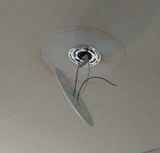

Here is a picture of my wago nut fix and new mounting plate and new lamps. 3 color switchable 3k, 4k and 5k. These lamps come with hardware to flush mount them and with spring clips to mount them on a can. IE: used same ones in Kitchen projects (two kitchens).
