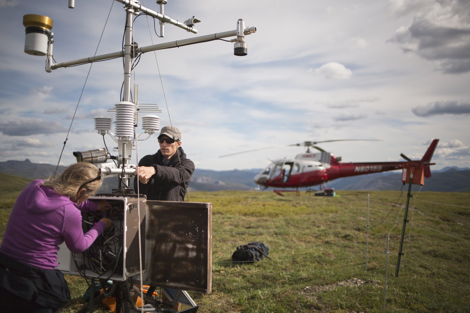

I wonder what kind of camera is being utilize in the attached picture.  Kind of odd that the Rain bucket appears to be held up by black tape.
Makes me feel a little better about some of the flaky stuff that I've done in a pinch.
