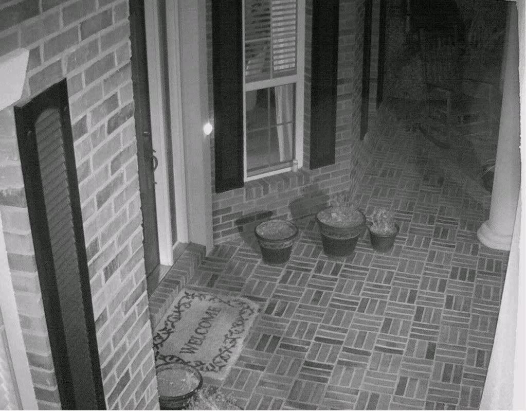

Here is a night shot from an ACM-1231, which goes for about $475 (it is also outdoor rated, so you would not need a housing with it) This IP camera does have built in infrared illumination:
http://i251.photobucket.com/albums/gg286/T...n/FrontActi.jpg
