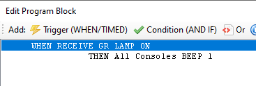

I'm using the BEEP 1 for testing to make the consoles beep when it does receive a message. The message here is GR LAMP ON.

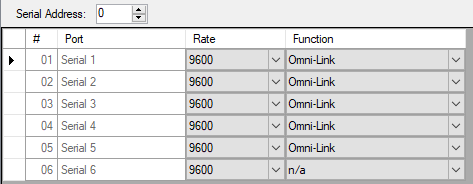

I set Serial 1 to 9600 and Omni-Link and the Serial Address to 0. PC Access works just fine.

Your MX-3000 serial communications is misconfigured and should be using "pro-link" serial comm.
Universal MX-3000 remotes all over the house that using a MSC-400 send serial commands to the OMNI.
I have no clue about this device. Googling some from 2010 see something about using Pro-Link serial communications with the MSC-400.
Here is what you need to do in order to send "message" command to an hai controller.
1) You need to set the HAI serial port setting that is tied to your msc-400 controller in "pro-link" mode in your hai configuration.
"Omni link" mode is quite complicated and requires authentifications, login and most of all crc check calculations so it is really difficult to build a string.
On the other hand, "pro-link" is super easy to make work so apply this change to your hai rs232 port.

You are never going to believe this, IT'S FINALLY WORKING AGAIN!!! It was the ProLink setup. I tried it no less than 3 times during all my testing and it never seemed to work and I thought I was just being silly trying the same thing over and over. I suspect I may have had another link in the chain broke during the testing of the ProLink setting.
Before making this last change you provided in your post, I wiped everything again and started with a completely fresh setup and still couldn't get it to work (using Omni-link). I even noticed when using PCA via serial, that it failed during a Write to Controller at 2048. I assumed the buffer was full and wasn't actually communicating. At this point I was sure the serial controller or something is dead.
