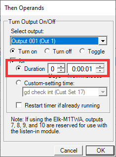

You should be able to specify the duration:

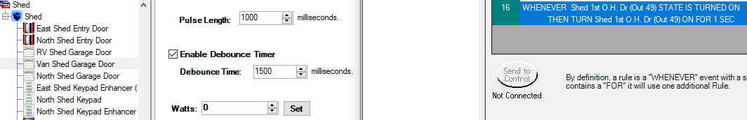

Thank you. Sorry. I should have clarified.
The request for Relay49 On is coming from another automation platform (Control4).
The issue I'm having is that it's sending latching command, even though in C4 it looks like just a momentary signal (1000ms).
So now, I need something in ELK to limit how long the relay stays on.
This is what I put in right now but wanted to make sure it would work before I uploaded it.
