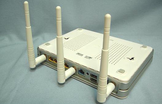

Checked the speed with Filezilla and a 500 MB file. Wired connection and fiber is working fine. Wireless in the shop is the issue. It's an old router so will swap it out.

Might try to fix the router. There are a bunch of places that mention a capacitor that fails in this model and can be replaced. Think I may have done that once already though...
Asus RT-N16. I opened the case and confirmed that I replaced the cap that many others report replacing some years ago. Maybe it went out again. Would be easy enough to replace them all.

I have been running ddwrt almost since I got it. It works ok so no real reason to switch - too many rabbit holes of this kind of stuff to do everything... :)
