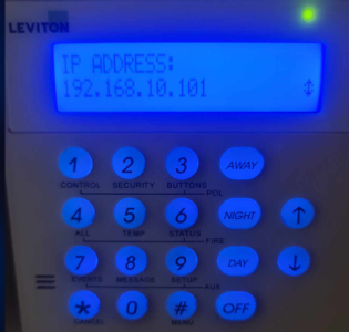

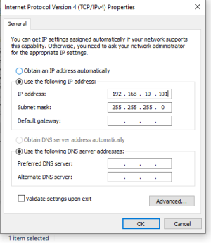

i am using ethernet port J6 directly connected to my laptop. Wifi is off.
In the laptop i made the Local area network to have alternative IP address as below.

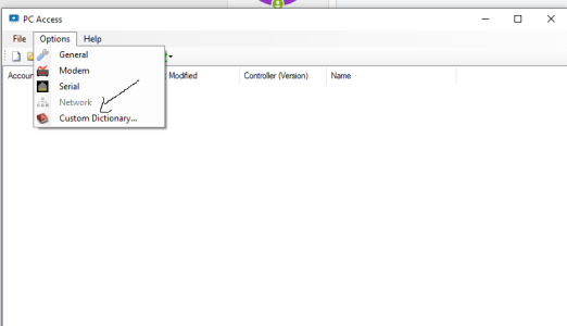

However, after i open the app PC access the Network is disabled.
Write down the 2 sets of keys you see in the console (or take picture).
In PC Access; configure new and put in IP address and keys and installer passcode.
In PC Access ; connect and download and save configuration. There go to status / units to control lights. Note that PC Access is a configuration utility but not a management utility.
