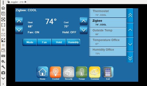

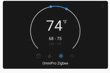

Here is an Omnibridge view of the Zigbee thermostat and an OmniProTouch view of same thermostat. (TMI).
Here running Homeseer Touch and HAI OmniProTouch on 15 tabletop 8" touchscreen computers. Due to WAF have only two in wall touchscreens these days. The zigbee polling makes it really slow to respond compared to the serially connected thermostat. Omnitouchpro thermostat.jpg

I am using a Ring to MQTT (cloud connection) plugin which works with Home Assistant and Home Seer MQTT. I do not use the Android app to manage it unless I want to make a change. House number two is all WiFi Tasmota switches, Tasmota everything, Alexa and Ring (ZWave stuff).

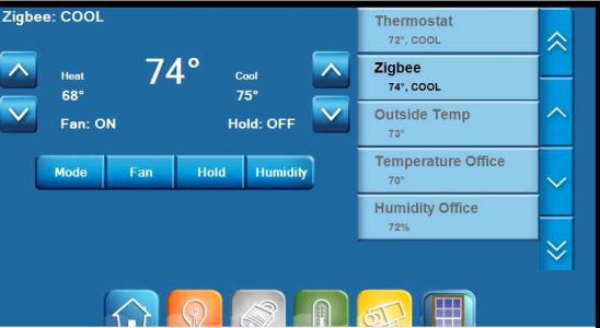

My is still running here on same batteries along with original Omnistat 2 serially connect. Let me try the old button....be back in a minute..will take a picture of the Omnitouch pro software ....
Hold doesn't work from thermostat to Omnitouch and Omnitouch to thermostat.
Works fine with Omnistat2 both ways.

Tried to change hold on and hold off on the Zigbee zim and it is the same...changes are not seen on the thermostat...only on Omnitouch..took it apart and see traces for what may be a humidity sensor on it...
