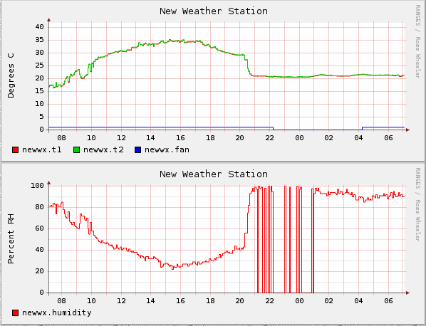

3 months ago I built a force-aspirated temperature and humidity sensor using a WC board, two DS18B20 sensors and the specified Honeywell humidity sensor. Yesterday we had rain for only the second time in 3 months. Temperature plunged rapidly, humidity rose quickly (entirely as expected) - but then the humidity sensor started returning stupid (nonsense) values - I suspect you are not doing any "bounds checking" on the value returned, and if it's over about 98%, your code simply fails and returns 0. (See graphs)
I would argue this is a bug, and even if the input "shouldn't" go over 100%, returning 0 is far more problematic.

I built my latest weatherstation with two DS18B20 chips and the humidity sensor all bunched together in the middle of a long tube.
Mounted the tube inside a second, larger tube.
Put a fan and a complete covering cowl over the top and a fine stainless gauze mesh over both ends.
The fan runs slowly and constantly draws fresh air in the bottom and out the top. It would be impossible for rain to get onto the sensors.
Yet during fog (particularly), and with constant rain, I was often seeing %RH toggling between 99% and 0%. With the simple test it has been perfect ever since.
