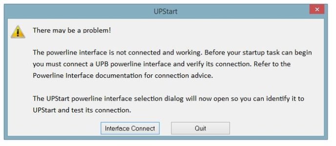

So there are different possibilities here. I was never a fan of this, but to save money, sometimes they would just use one real switch to control the lights, and the other two would be "remote" switches. These remote switches just used one wire to control the real switch. These "remote" switches don't typically have the same color indicator light as the real switches. The second way, and more expensive way is to use multiple real switches with some maybe not controlling any real lights. They are just transmitters that control the real switches via UPB. So the question is, which do you have? Real switches give a slight buzz when you press them, they may be warm, and feel better made. Remote switches don't buzz, don't get warm, and feel cheap. Remote switches don't usually go bad. Anyway, its easy in UPStart to replace a switch without much work.
