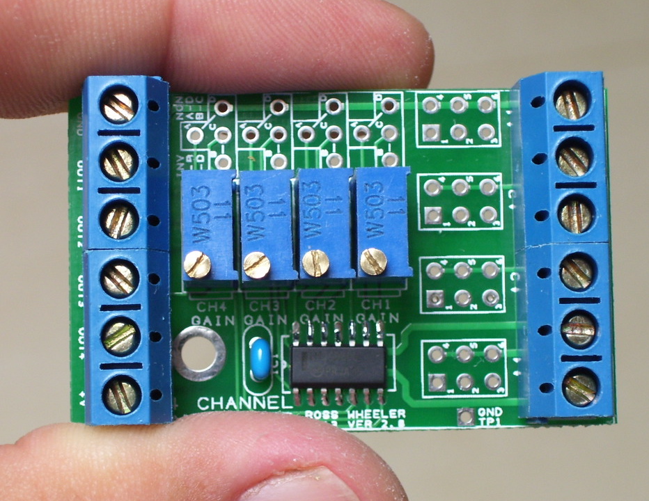

Agreed - if someone made a small board, perhaps with some amplifiers on it for added flexability, and sold it as a product - it'd be great.
(Is there any real demand for this? I already made <a href="http://webcontrol.rossw.net/4ChAmp/4ChAmp-top.jpg">4-channel amplifier boards</a>, perhaps an ideal marriage?)

With little additional cost, one could have four more analog channels, that is good addition to Ross' terminal board, I think.
