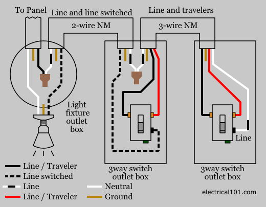

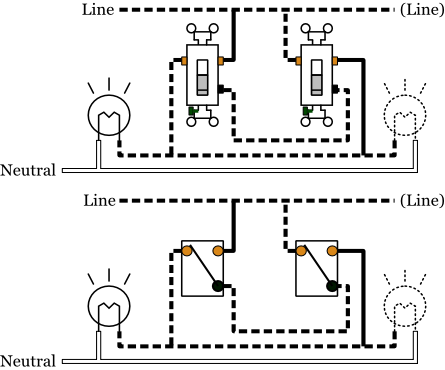

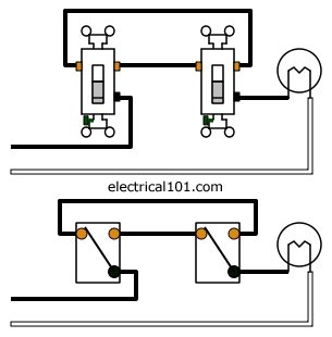

I am in the legacy process here of wiring 3 switches to one lamp.
Here switched over almost all switches to UPB in virtual 3-Way switches.
All the diagrams that I see use 2 three way switches and 1 4 way switch for this 3 switch scenario.
My box o legacy switches only has regular 3-way switches.
This is kind of temporary setup to see if I can do it.
Is there a way to do this with 3 3-way switches?
Answering my own question. Increasing multiway switches to more than two you need at least 1 4 way switch. You can go to more than 3 switches then using 1 4 way switch and multiple 3 way switches. I also found a 4 way switch in my box o switches.
