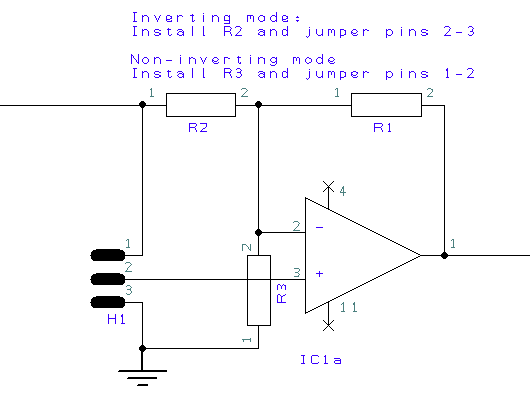

My terminal board has a quad opamp already layed out and connected. Since the WC board only has 3 A/D input channels available, only 3 of the opamps are connected, leaving one "spare" for other uses. I already published the circuit for one channel (all 4 are the same):
Depending on the sensor you use, it will probably have fairly small changes, the above circuit may be useful to amplify it to something more useful.
The "spare" opamp may assist you with some offset to give you a better span. Once you have the details for your sensor, if you post it here we may be able to make some suggestions as to what should work best.
