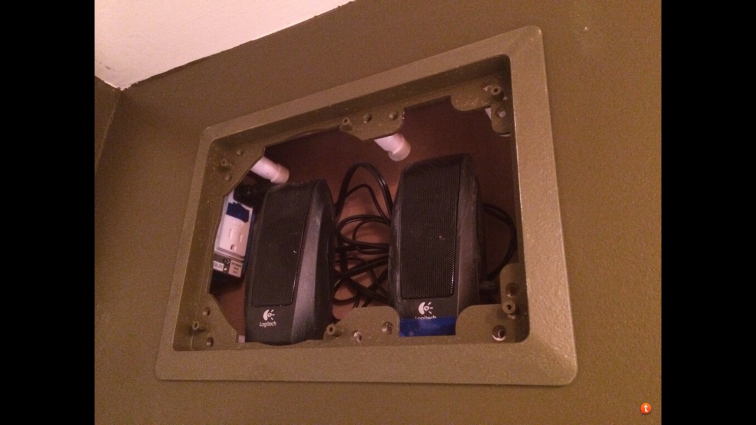

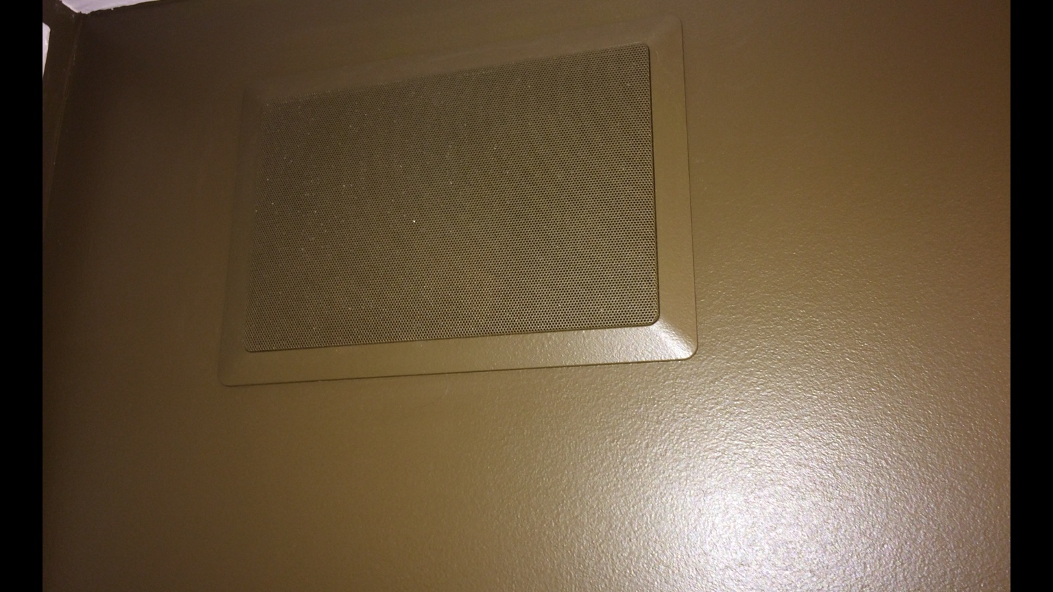

I actually have done this a few times in the house and have a few more locations I want to do:
Cut our drywall for speaker blank frame.
Place a 2x4 shelf along the bottom
Install an insteon outletlinc in a single gang box in cavity
Place a set of of speakers and an ELK speaker in cavity
Run line level signal from central distribution point and elk outplay from ELK to elk speaker
Cover with grill
Paint grill and frame
The PC speakers can be turned on and off with the outletlinc and are used for voice announcements throughout the house.
The ELK speaker is basically a siren
Once painted, it's barely noticeable.

Me, I'd rather have the the equipment centralized, with as little as possible at the in-wall point.  Buried AC outlets, transformers and the like make me a little nervous when it comes to potential fire risks.
As I automate things I try to think what the next person running this house is going to think of what I install.  There's a part of me that really doesn't want to end up on one of those DIY nightmare slide-shows.

I generally try to avoid doing anything that a professional wouldn't do, in my house.  As I live and learn, I'm trying to go back to fix all the things I did poorly a few years ago.
I think the speaker grill is a fine idea, though, to hide local equipment, if it can't be located in the closet.  Outlet in a junction box, still accessible, works for me.
What I did meets all local code for accessibility of the outlet. It's really nothing more than an "alcove".
I honestly would like to hear from Del how he would accomplish the same objectives.
