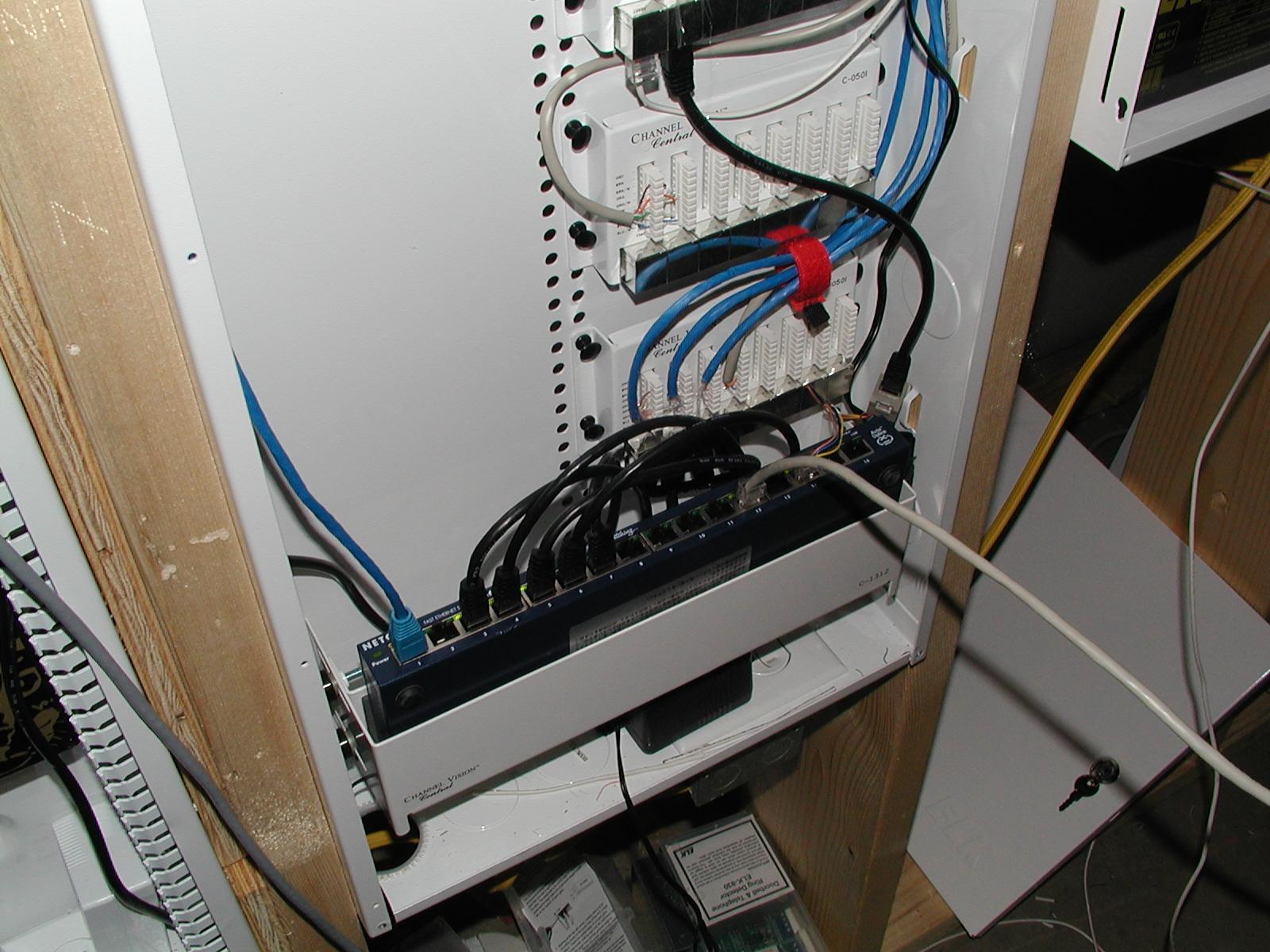

Thanks for the pic, Dan. I figured out I'll have to position the switch at the top or bottom of my one can, if I want to use wire channel along the sides. I'll try to pick up some cheap, locally.

I splurged and bought the 2" CV extension ring, and a hinged adapter plate.
I'll try mounting the modem and router on the hinged plate, overlying the switch. I won't be accessing the switch often, so repeated motion of the cables shouldn't be a big issue.
I'll have to partially amputate the router's legs, but I'm confident the patient will pull through.
I'll likely use some industrial velcro for the router and modem, but do you know of any adapter plate options that use straps?
I think I saw an Omni module mounted with some kind of strap across the front, somewhere.
I used the foam tape that came with my Elk M1 (or one of its accessories), it's pretty heavy duty, works really well. In the past, I have also taken some components apart, and attached the housing/case to a blank plate, then put it back together. Lots of options for sure.
