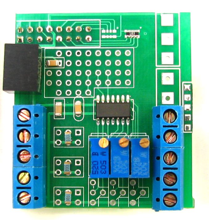

Efried said:Since there is a large unused area on the WC (which ais also not used for wireless) I propose adding a prototype area...
rossw said:You mean something like this?
(Current WebAmp board, this one is kitted out for operation as 3 x 4-20mA current loop input, and has a 8-28V DC input that will also operate the WebControl8 board with barely any temperature rise at all)
Efried said:Great yes, but I would see space on the WC8 itself for a prototyping area.
rossw said:I doubt it's going to happen. That would require CAI completely re-tooling for a new revision board.
I know there's a new board in the works, I very much doubt a prototyping area on-board is on the radar.
(Just out of interest - what would you plan to put there? All the inputs are on a 16-pin header, so you couldn't readily do any input conditioning, you'd have to cut tracks to connect to them anyway, and it strikes me as a fairly non-useful addition)
Efried said:I would sport photo MOS SSR, but there is space for the whole mini-monster.ru as watchdog. Is it possible drilling holes into the existing board, then I could do the wiring in the ugly way?
