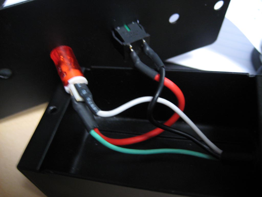

If that black thing is the pushbutton, why not just cut the red and black wire from it and wire those to the relay? That way you still have the LED which will help let you know when it's on and off.
That other relay will work fine as long as the 12 volt wall wart is capable of at least 75 milliamps (just wire its output to the coil). Advantage is you don't have to mess with the appliance module in case you feel like switching this with a relay with an Elk module and it's 12 volt supply.
I don't think the relay would fit well into the included enclosure, and I kind of want to just cut that remote off and keep it as-is for later. The LED only indicates when it's ready to fog (not really if it's on or off), and it's going to be outside anyway - so I won't be able to see it. The unit itself has its own LED anyway, so this one is redundant for my use.
So, assuming I just cut the remote off, do you think my guess is right based on what you see in the photo? Black and green?

The one I'm going to try is using one of these: http://www.radioshack.com/product/index.js...rentPage=search and I'll just be cuttong the wire to the pushbutton and rigging the relay in there instead.
The relay will be powered by a 12V wall wart, which I already have in my garage to power one of my aux. garage door openers (goes with my car alarm to also control the garage)... and my output expanders are right there in the same location in the garage.
