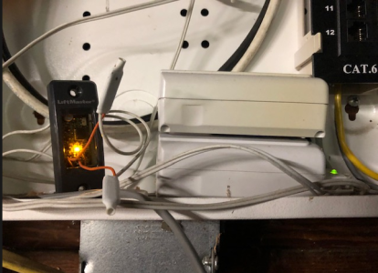

On the Chamberlain/Liftmaster you can hack the pushbutton to operate it with a relay of your choice in my case an Insteon I/O Link.

The newer Liftmaster GDOs utilize digital buttons. You can purchase a digital button from Amazon for around $10 USD.
There are traces on the button to solder two wires for use with a regular button.
