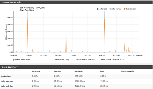

Found the monitoring graphs in pfsense.

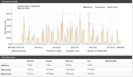

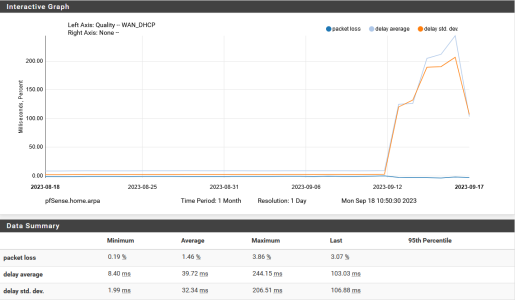

1 day, 1 week, and 1 month views. Note the resolution goes down with increasing time span so the 1 year view is practically useless and in fact shows some spikes of negative packet loss. :) The month view though clearly shows the start of the issue about 5 days ago before I noticed the issue. This gives me some help setting thresholds and I need to figure out if it can send me a warning alert.
1day
1 week:
1 month:
It is suggested that the monitor IP be somewhere within the providers infrastructure. The default is the gateway IP which is the box sitting in my basement so the connection to it is usually good even if the incoming signal to it from Spectrum is completely gone. I could use the google DNS. Do I just enter the numeric IP for spectrums web page or how do I figure out what to use?
Tech checked out things and it seems to be working a bit better but said it was really a mainline issue, they have been doing a lot of work in the area, yada, yada... and that it was another group that would be addressing main line issues. The packet loss graphs have settled down, at least for now.
