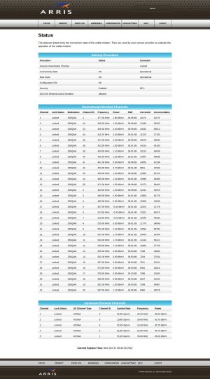

Here is the diagnostic web page:
Google optimal numbers for diagnostics for comparison. I tried the newer Arris SB8200 (90 days) and it was OK but looking now at the Motorola Gb modem.
SB6190: CABLE SIGNAL LEVELS
